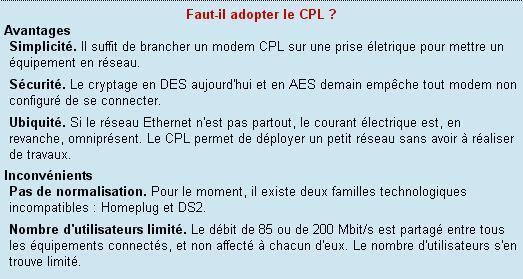

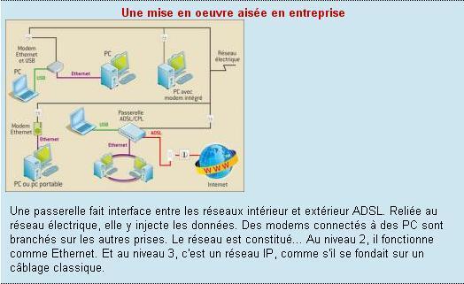

Invité ____ Publication: 25 novembre 2007 Publication: 25 novembre 2007 http://www.cheminots.net/forum/uploads/post-1906-1196022583.jpghttp://www.cheminots.net/forum/uploads/post-1906-1196022593.jpg http://benkirane.over-blog.com/article-3985821.html
